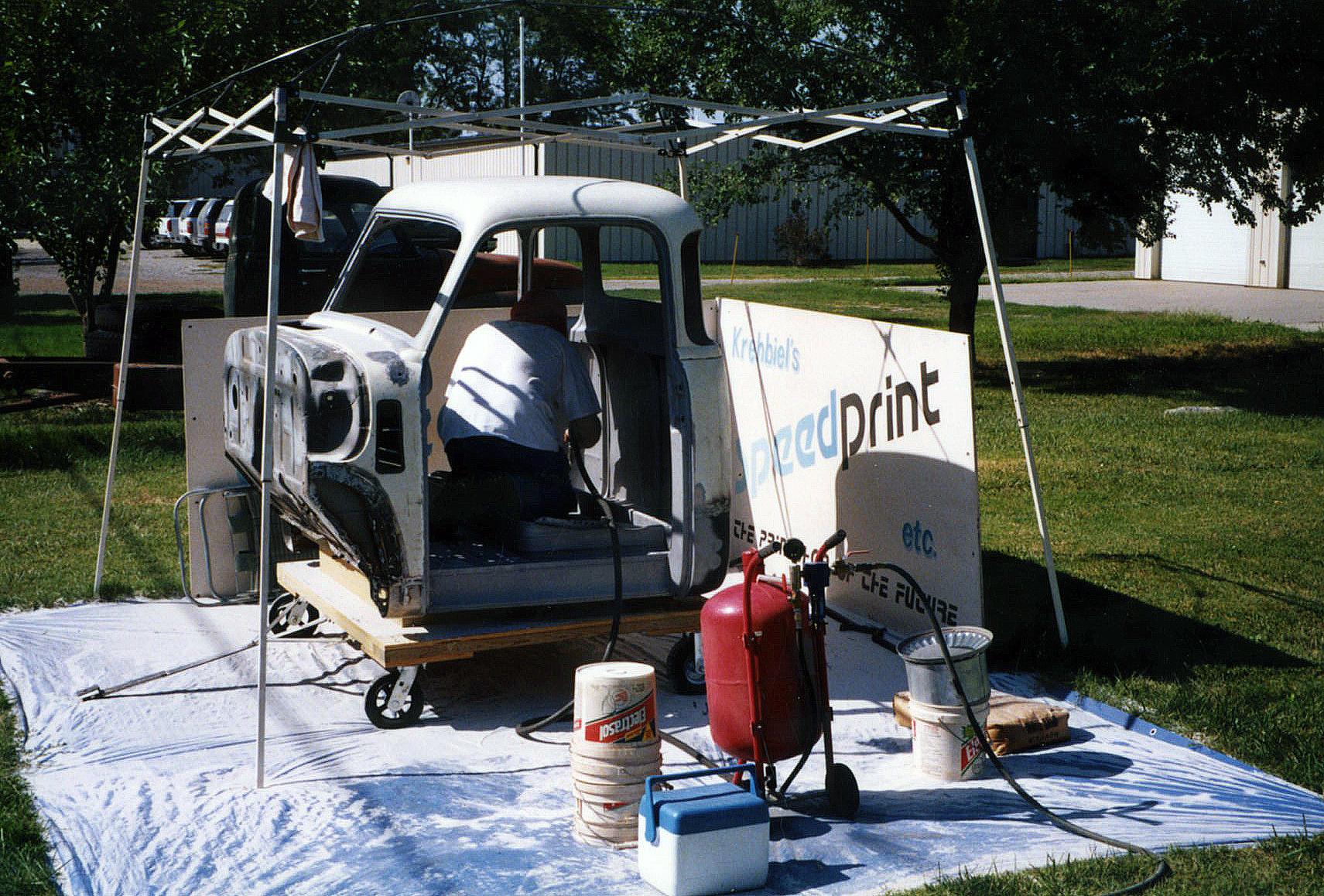

For outside work, and on one vehicle only, you can get by with a siphon blaster. They are about $50 at Sears and I have done an entire '50 Chevy Pickup with one. They are slower (much slower) than pressurized, but are less problematic, cheaper, and require fewer replacement nozzles since they don't wear out as quickly. Since the sand doesn't come out at near the velocity as pressurized, you can retain more sand in the local area for re-use. As you can see, there are advantages to siphon blasting, but if you are a serious restorer and will be doing more than one vehicle, pressurized is definitely better.
Pressurized blasters work by pressurizing a tank filled with the blasting sand. This pushes the sand out at high speeds and cuts the paint and rust much quicker. I figure about 4 times quicker than siphon blasting. Decent Pressurized blasters start at about $100. I purchased a Harbor Freight 40 pound pressurized blaster for $79.95. This would be a bad idea if you weren't ready to put another $80 into it right away to make it usable. The water trap is plastic and broke after the first hour, the sand hose lasted two days, the nozzle valve lasted about 2 days, the ceramic nozzles last about 5 hours. I went down to the local tool store (didn't have to twist my arm to do that!) and purchased a glass water trap and a 15 foot piece of 320 pound pressure GoodYear hose. I then ordered a carbide nozzle from sandblast-nozzles.com (part no. TL2-1) in the 3/32" size. The 3/32" is really the best size for the sand I use and the pressure I need. I was able to maintain about 80 pounds of pressure with my setup using that nozzle. I was very satisfied. Make sure the pressurized blaster you use comes with a choke valve. On high humidity days you will have clogging problems and this choke valve eliminates that problem.
If I had it to do all over again, I would purchase my pressurized system from Brut Mfg. You can call them at (888) 533-2693 or go to www.brutmfg.com. It's more expensive, but the parts are more readily available. Harbor Freight gets all the replacement parts from China and they have to wait for the ship to come in. This means sometimes months before your replacement parts are available. If you plan for that, you are fine with your Harbor Freight unit, but Brut Mfg puts out higher quality American made equipment. I spent 5 weeks of 10 hour days in 100 degree heat this summer blasting the equivalent of two entire trucks (frame and all associated sheet metal). I am very glad it's over! Special thanks to Fred Zwicker from the late Truman's, Inc. for his insight and input into this article.
